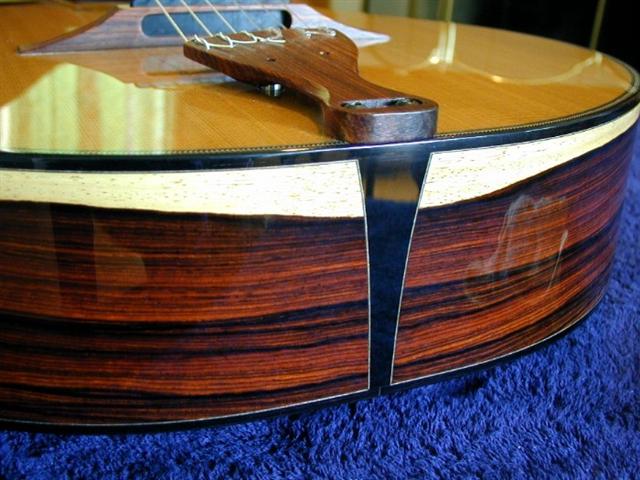

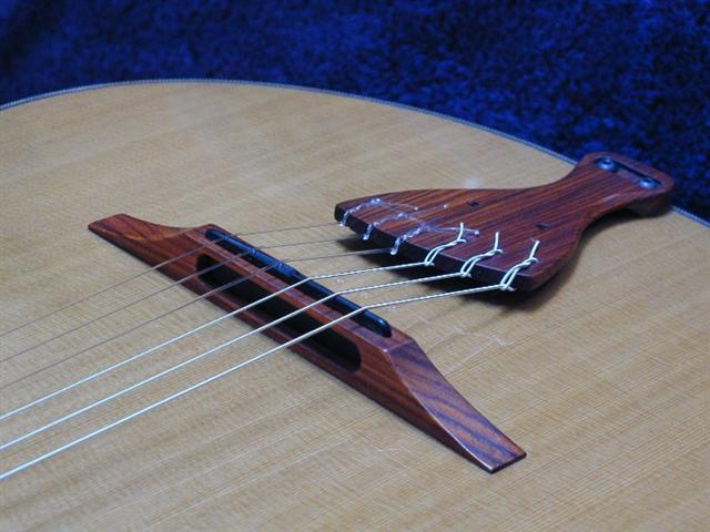

I've always been enamored by Kevin Ko's work. Kevin has a US patent on his anchor system for this guitar.

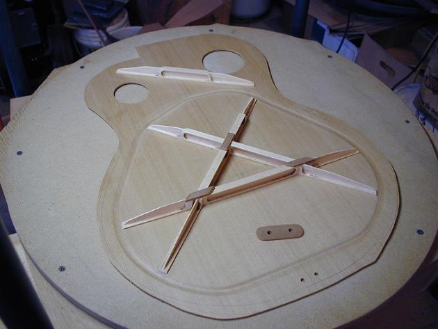

And check out his bracing -- KEVIN IF YOUR OUT THERE! Tell us about this -Please!

The bracing is very nice and seems to make sense for a Nylon string. lance did you say he a patent on the Bracing?
PostPosted: Tue Apr 05, 2005 1:57 am
Not the bracing - the block that supports the string attachment.
PostPosted: Tue Apr 05, 2005 2:04 am
Thanks for the Clear-me-up. or are you just picking on me again?

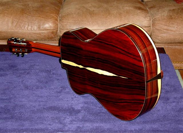

worse yet, isn't that the face of a noseless demon staring at us in the fifth photo ----   REMOVE IT   ----   i'm terrified!!!!!!!!!!! where is the cyber black tape when we really need it??
in all seriousness, the top construction appears rather complex. is the raised inner portion a doubled top?
but at least his cut away would be easy to bend.
michael mcclain
PostPosted: Tue Apr 05, 2005 2:33 am
I believe the top is solid, and has a routed channel around the perimeter to act as a speaker cone would. Kevin has gotten a lot of very positive reviews with this design.

That bracing pattern and the groove in the top totally goes against everything that I understand about the vibration of tops. That's what's called a learning experience, and you have to hate those.

i obviously misinterpreted the photo.
the groove stirs other questions:
PostPosted: Tue Apr 05, 2005 9:56 am
lance
i really misinterpreted the photo!
the groove causes other questions to arise:
    how thick is the top overall so that the groove does
      not overly weaken it?
    what is the brace material? they appear to be
      a different sort material, perhaps even machined or
      moulded.
    using the tailpiece, does he glue his bridge or leave
      free like an archtop?

Just looking at it, I would say the braces are machined spruce and the top is cedar.
Actually, the overall bracing pattern confounded me so much that I didn't really think about the braces. That is pretty much what an engineer that wanted light and stiff would design. If the flange on the top is big enough to take the load, the material in the middle doesn't contribute significant resistance to bending, just weight. That's why many structures are made of I beams.
Since the bridge doesn't take any string load, things can be very different.
Clearly, he's making a big fairly rigid piston at the bridge. Very interesting.
